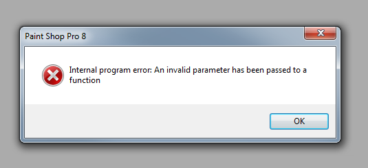

I forgot how to import and export the right way in PaintShop 8.0. I can pull a frame from the animation into PSP, but putting it back in has been hit and miss. While exporting, I thought it was editing it live? Doesn't seem to be...
I can create frames and make the animation the way you show just fine (create->import). It's in opening a long animation and wanting to edit a few frames in PSP where I run into issues (like a 20 second avi). I'll fire it up tonight and find a specific step I'm having issues with for an actual question.

Paintshop Pro won't edit the individual frames of an animated gif. It will only open up the first frame.
You'll need an animated gif creator/editor in order to edit at the per frame level.

Might be a version difference. I use to have an issue, but I can't duplicate that problem now. Here's PSP 8.0 editing the 3rd frame of your folding/[PC] tag:
Opening the GIF, selecting the 3rd frame, then exporting via right click:
PSP opens up with this frame ready to edit. Layers->Merge->Flatten/All
Insert One Man Wolfpack halloween costume, close->no to save->yes to update
One Man Wolfpack is now 3rd frame of animation
This is where it use to puke and error out just a few months ago. I guess it's working, so I'll go back to playing and try to make it crash. I think I had been choosing "export into open frame"
Edit: Yup! When I try to export, it collides when I should just close it and follow the prompts.
