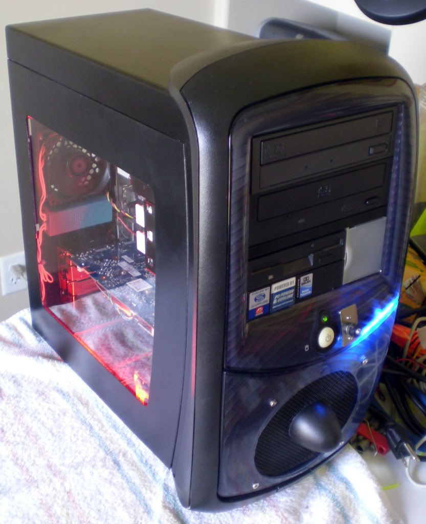

Alright, I've finally found time to take more pics. The mod is very nearly finished, just need to finish the front-panel lighting and the front-panel USB ports.
Unfortunately I did a lot of work on it between now and the last time I took pictures, so I don't really have any pics of the making of this stuff.
Finished the turbine. It isn't perfect, but I think it turned out quite well:
The fan's panel is mounted on a hinge and simply clicks in and out, making maintenance on the filter and fan extremely easy:
Fan is a Scythe Kaze Slim 120x12mm. The filter serves a dual purpose. First, it blocks dust, and second, it blocks the red light from the inside, as the front panel glows blue and I don't want it to clash.
In case you were wondering what that knob and metal plate contraption is on the front panel, it's a switch for a 5-LED light I installed in the front panel.

This is very nicely done, Spartacus. Believe me, I'm taking notes. Very clean work.
You never did say exactly which paint you used on the plastic parts on the front. I'm curious to know, because I would like to paint my own case, but all my outside case panels are ABS plastic(!) snapped onto a steel frame. :roll:

The first time I painted the front panel I used Rust-Oleum paint that is specifically for plastic. It stuck and looked great, but it was textured and I didn't like that. When i repainted the front I used two coats (or three. I think it was two) of automotive primer, sanded, and then used vanilla Krylon black paint. After that dried for two days, I used Krylon satin clear coat to seal it. So far it's been quite scratch resistant and I'm very happy with the results.
Another note. the best way I found to get a very smooth finish without the hassle of wet-sanding or airbrushing is to first sand it down with some standard very fine-grit sandpaper, and then use some 3M ultrafine sandpaper. That sandpaper is sort of like a very thin sponge with one side that is somewhat rough. You can make the coat of primer smooth as silk with enough passes of that thing.
