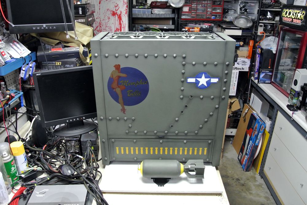

Ok folks, time to get back in the modding saddle! Having completed all my commissioned obligations for the time being, I thought it would be a good time to start my next personal project. This time I'll be taking on the gargantuan "Ultra Tower", the Cosmos II. I've always wanted to do a hotrod-themed build, and I think the Cosmos II lends itself well to this theme with its sleek, aerodynamic lines, and beefy roll-bar type handles. I'll be playing off these features, moving some things around, and generally wreaking havoc on this poor case, but in the end you'll still be able to distinguish it as a Cosmos II. :)
The first thing you'll notice is the open-air design. I actually hated to get rid of those cool doors, but I wanted that open engine compartment feel. And with pretty much everything watercooled, there would be no reason to worry about airflow. Next is the watercooling manifold. I spent the most of my design time on this part, as it has to be functional, as well as look like an actual automotive component for fuel delivery. It will accommodate two separate loops: One for the video cards, and one for CPU, memory, and motherboard.
