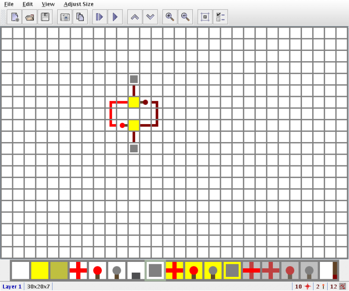

Edit: also, can someone share some tips on creating a ui via windows forms so I can design a ui like this: Image
or this: Image
