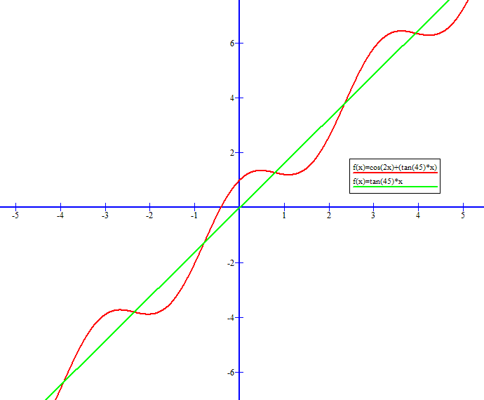

this is as close to what i have gotten. basically, i just added a linear function to the cosine function where the slope of the linear function is an angle of my choosing
f(x,θ) = cos(x) + (tan(θ)*x) where θ is the angle i want the curve at
this is both ugly, and not what i want. the green line is the linear function i added

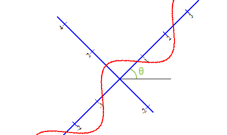

this is what im looking for. i just rotated the first image 45 degrees in gimp. θ is the angle the wave is tilted
what i want to know is the mathematical function that generates a cosine wave that looks like the third image. i want to implement this into a little sprite game im working on, but i dont know the math to put it at an angle. iv toyed with the idea of using f(x) = cos(x) and just tilting the result, but i dont really know how to program that either, but what im mainly looking for is the math behind a tilted cosine graph.

Rotation of 45 degrees ccw is
(x,y) → ((x/sqrt2)-(y/sqrt2)),((x/sqrt2)+(y/sqrt2))
I'm not sure what language you are programming in, so a bit of pseudocode
int x, y
x=sinwavex()
y=sinewavey()
x=((x/sqrt2)-(y/sqrt2))
y=((x/sqrt2)+(y/sqrt2))
not sure if this is the best solution, but it should work
at least it did in wolfram alpha
http://www.wolframalpha.com/input/?i=Ro ... Pi%2F4%2C+{0%2C+0}%5D%5B{x%2C+sin%28x%29}%5D
