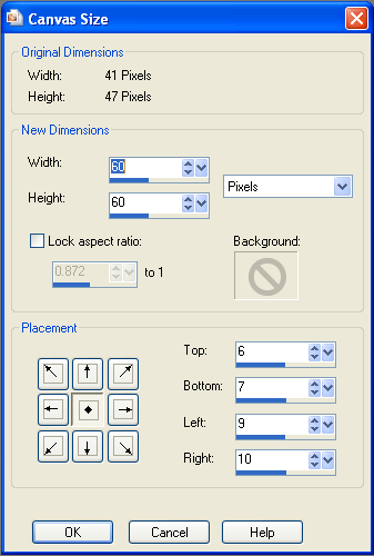

The right head will need the rest of it's head when in the down position. To do this go to the copied head picture you created earlier. Currently we don't have room to do what we want so we need to increase the canvas size. Go to the "Image" menu and select canvas size. A dialog box will appear that shows the original image size. You can then enter a larger canvas size in the middle section of this dialog. We don't need that much so we'll make the new canvas size 60x60 pixels.
Now that we have room to add the missing information use a combination of the "Push" and "Clone" tools to complete the top of the head. An alternative could be to copy the top of the left head and paste it on the right head but that too would require extra work to make it look natural. You'll need to use some artistic skills to make the added parts look matched. If you need help on this I'll elaborate further in this post.

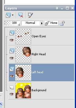

#4 Create Layers

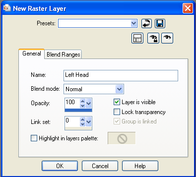

In the original picture go to the "Layers" menu and select "New Raster Layer". You can name the layer if you want to keep things organized. I named it "Left Head". The default settings are what we want so just click okay. Now that we have a new layer in the "Layers View" make sure that new layer is selected (highlighted). Now go to the picture of the left head that you created and copy it "CTRL-C" and paste it into the new layer using "CTRL-E". Move the head so that it covers the same spot as the original postion of that head. (Note: "CTRL-V" pastes as a new image while "CTRL-E" pastes into the current image)
New Layer Dialog and the Layers View Panel.
Image...Image
Now create a layer for the Right Head and copy the right head into that layer and postition it where it originally was.
For the eyes we are going to do something different. Create a new layer for the open eyes and name it "Open Eyes" and copy and paste the open set of eyes over top of both the left and right heads so that it looks like their eyes are open.

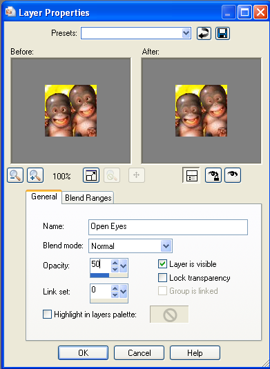

For this frame we are going to have the eyes half closed. To do this select the "Open Eyes" layer. To create the illusion of a half closed eye decrease the opacity of this layer to 50%. Right Click the "Open Eyes" layer and then select "Properties". The same dialog box that you used to create the layer pops up. Enter 50 into the "Opacity" field and click OK.
Save this frame as "002.bmp"

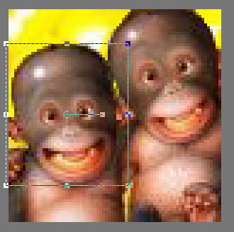

Now that the eyes are closed we will animate the head movements. Select the "Left Head" layer. Now select the "Pick" tool. A box with nodes will appear around the head. Move the cursor over the middle node. The cursor should change into a four way arrow. Now move the head down one step. For this example it's only about 2 or 3 pixels.
Now select the "Right Head" layer and repeat the last step for this head.
Save this frame as "004.bmp"

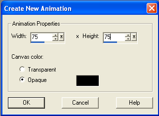

Open Animation Shop.
Go to "File" and select "New". A dialog box will come up that has options for the frame dimensions and the background colour. Use the width and height of the frames that we just created and click OK.
